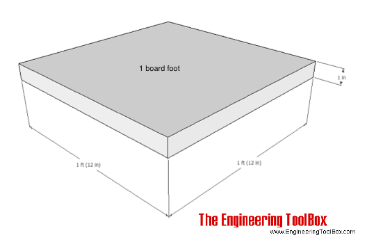

One board foot of lumber is one square foot that is one inch thick. Board foot is a volume measurement used for lumber, where
  • 1 board foot = 144 in3 = 1⁄12 ft3 = 2360 cm3 = 2.360 liters = 0.002360 m3
board foot

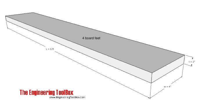

Board Feet Calculator
board feet example
Default values for a piece of lumber with dimensions 2" x 4" x 6'.

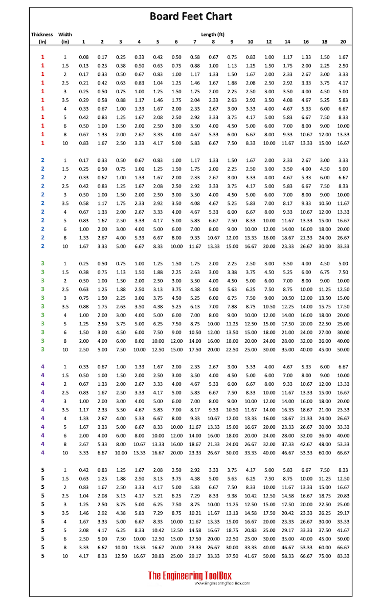

Board Feet Chart - HardWood & Softwood
Example - Beard Feet
The board feet for lumber 3 inches thick, 2 inches wide and 12 ft long - can be calculated as
BF = (3 in) (2 in) (12 ft) / 12
    = 6 board feet
- as indicated in the table above.
