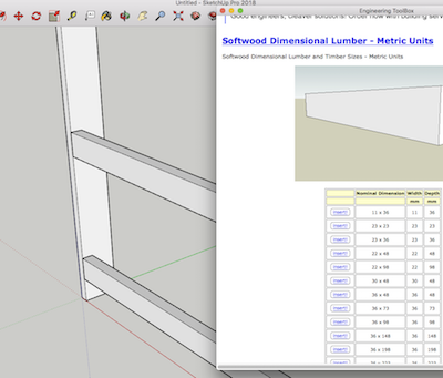

Engineering ToolBox Sketchup Extension - Insert Construction Lumber
Use the Engineering ToolBox - SketchUp Extension - to add Construction Lumber to Your Models
