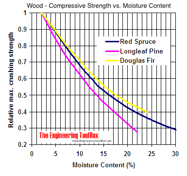

Moisture content influence compressive (parallel to grain) strength of Red Spruce, Longleaf Pine and Douglas Fir:
wood moisture content versur compressive strength
Indicated strengths are relative to wood containing 2% moisture.
  • Red Spruce - air dried : 14% moisture content, kiln dried : 6% moisture content
  • Longleaf Pine - green wood : 20 % moisture content
  • Douglas Fir - green wood : 24 % moisture content
Example - Compressive Strength of Moist Spruce
The compressive strenght of spruce is normally in the range 18 - 39 MPa (2610 - 5655 psi). The diagram above indicatees that maximum strengt is reduced to 50% for spruce with 16% moisture. The reduced range can be calculated as
[18 - 39 MPa (2610 - 5655 psi)] * 0.5
                       = 9 - 19.5 MPa (1305 - 2828 psi)
