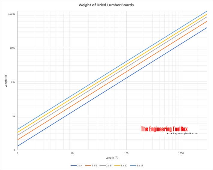

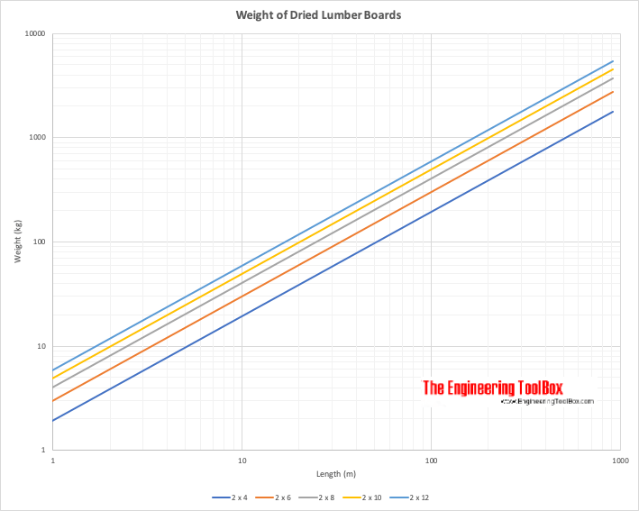

Kiln Dried Lumber Boards
Kiln Dried Lumber Boards - Weights
Weight (lb)
Nominal
Dimension
(in x in)
Length (ft)
18101216
2 x 4 1.3 11 13 16 21
2 x 6 2 16 20 24 32
2 x 8 2.7 21 27 32 43
2 x 10 3.3 27 33 40 53
2 x 12 4 32 40 48 64
Weight of dry kilned lumber boards - imperial units
  • Right click the chart and open in new window for printing
Weight of dry kilned lumber boards - metric units

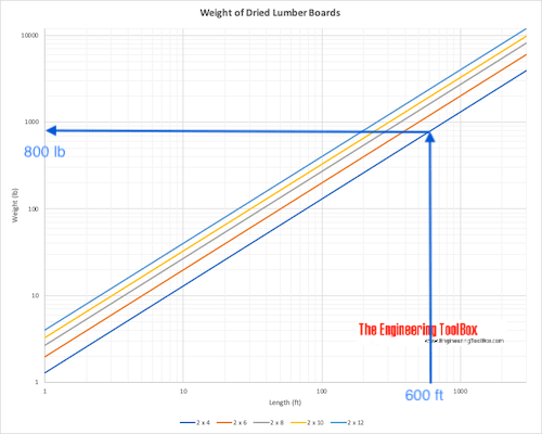

Example - Estimating Shipment Weight of Lumber
Shipment Lumber Weight - example
The shipment weight of 600 ft 2 x 4 dried lumber can be estimated from the chart to be approximately
800 lb

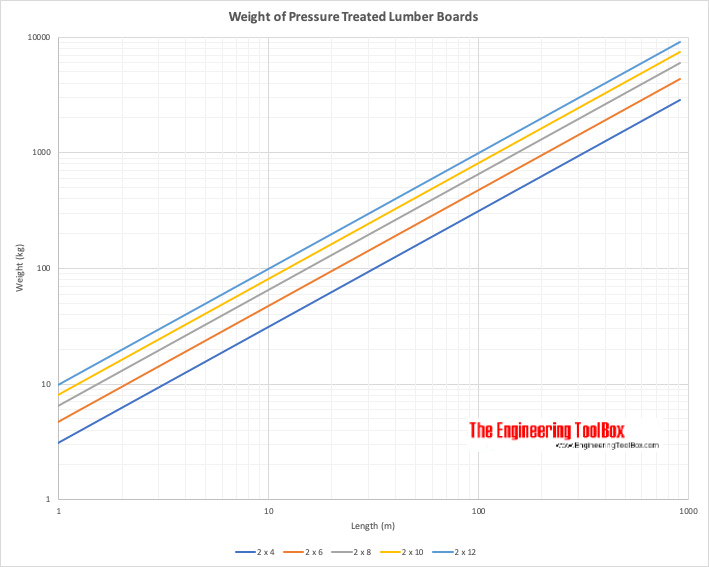

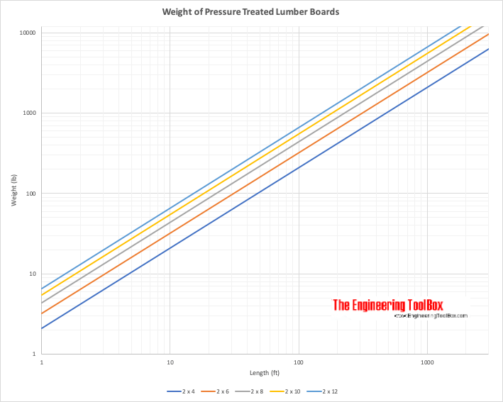

Pressure Treated Lumber Boards
Pressure treated with chemical preservatives.
Pressure Treated Lumber Boards - Weights
Weight (lb)
Nominal
Dimension
(in x in)
Length (ft)
18101216
2 x 4 2.1 17 21 26 34
2 x 6 3.2 26 32 38 51
2 x 8 4.4 35 44 53 70
2 x 10 5.5 44 55 66 88
2 x 12 6.6 53 66 79 106
4 x 4 4.8 38 48 58 77
4 x 6 7 56 70 84 112
4 x 8 9.3 75 93 112 149
4 x10 11.7 93 117 140 187
4 x 12 14 112 140 168 224
Weight of pressure treated lumber boards - imperial units
Weight of pressure treated lumber boards - metric units
