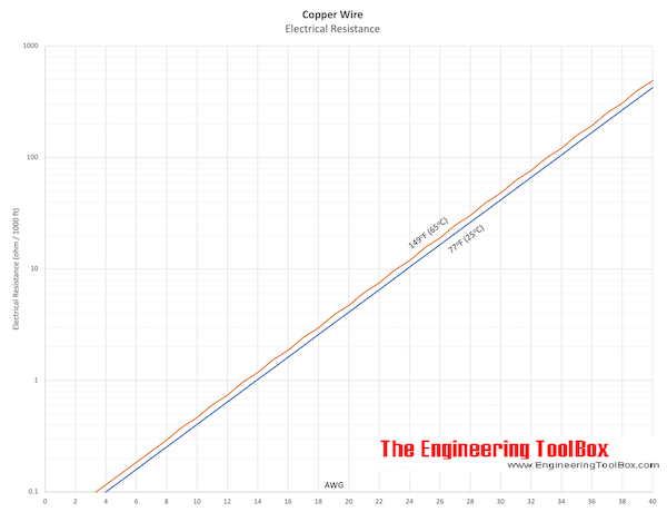

Copper Wire - electrical resistance vs. temperature
Download and print Copper Wire - electrical resistance vs. temperature chart
