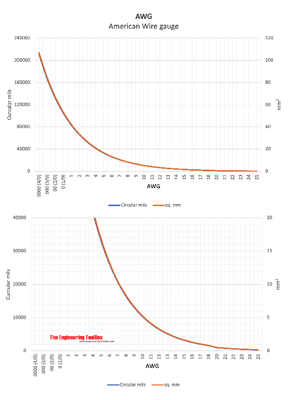

American Wire Gauge - AWG - circular mils and square mm chart
Download and print AWG - Circular mils and mm2 chart
