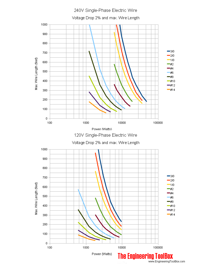

Maximum length of 240 V single phase electric wire with max. 2% voltage drop.
240 volt and 120 volt single-phase systems and maximum wire length with 2% voltage drop:
Wire ranging from AWG 3/0 to #14.
