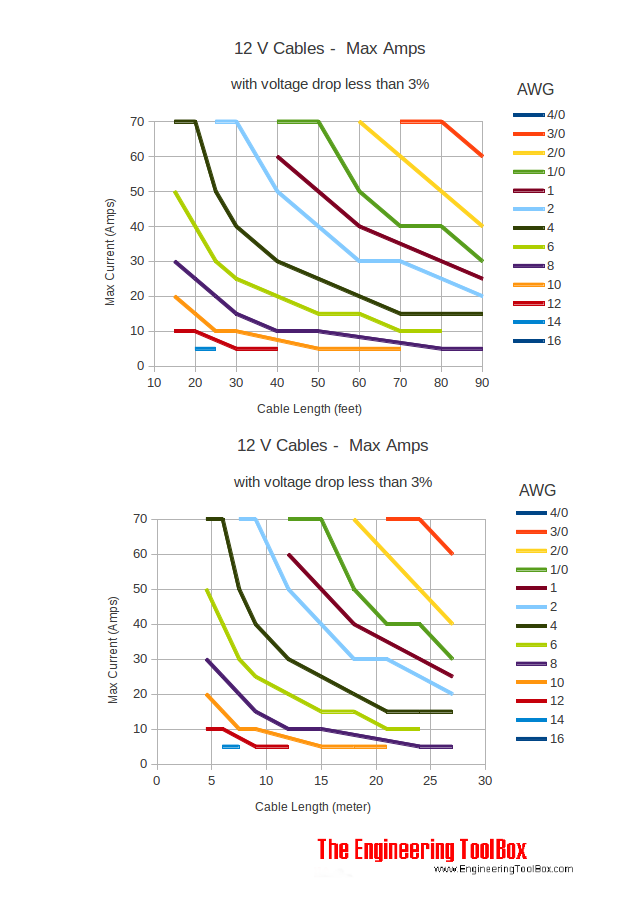

Maximum current (amps) in a 12V electrical circuit vs. size (AWG) and length of wire.
Conductors in electrical systems should not be sized with voltage drops exceeding 3%.
For a 12V system the maximum voltage drop should be less than (12 V) x 3% = 0.36 V.
Conductor sizes (AWG) related to maximum current through a 12V electrical copper wire and length of cable - are indicated below:

Note! Failure to use an adequate size may result in a fire. Always secure electric wires with fuses.
  • 1 ft (foot) = 0.3048 m
Wire Gauge Design Procedure
  1. calculate total length of wire from source to device and back again
  2. determine amount of current in wire
  3. determine correct wire gauge in the intersection of amps and feet
Note! Wire size based on 3% (0.36 V) voltage drop in a 12 Volt circuit. Always oversize wires if voltage drop is critical.
12 v cable length maximum amps
print 12V Cable Length Diagram
Example - 12 V Cable and Maximum Length and Current
The maximum current in a 12 Vgauge #6 (13.3 mm2) cable with length 15 m is approximately 15 amps according the diagram above.
The maximum current in a gauge #10(5.26 mm2cable with length 15 m is approximately 5 amps.
