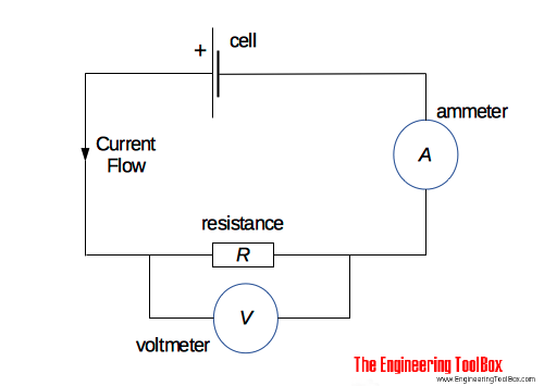

electric circuit

Ampere can be measured with an "ammeter" in series with the electric circuit. Currents usually expressed in amperes (A), milliamperes (1 mA = 10−3 A), microamperes (1μA=10−6A), nanoamperes (1 nA=10−9A), or picoamperes (1 pA = 10−12 A)

A "voltmeter" can be used to measure voltage and must be connected in parallel with the part of the circuit whose voltage is required.
