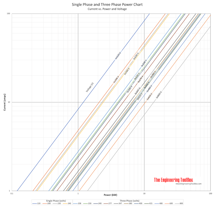

The diagram and table below can be used to convert amperage between single phase and three phase equipment and vice versa.
Single phase vs. three phase AC power, volts and current
Download and print Single Phase and Three Phase AC Power Chart
Example - Power Supply to Electric Heater
10 kW of power is required by an electric heater. The power supply available is 230V single or three phase. From the chart above we can estimate the current in the two alternatives to be approximately
  • 43 A with single phase 230V
  • 25 A with three phase 230V

Electric Power Nomogram
The nomogram below can be used to estimate power vs. voltage and ampere.
Electric Power Nomogram - Power vs. volt and ampere  Download and print the electric power vs. volt and ampere nomogram!
