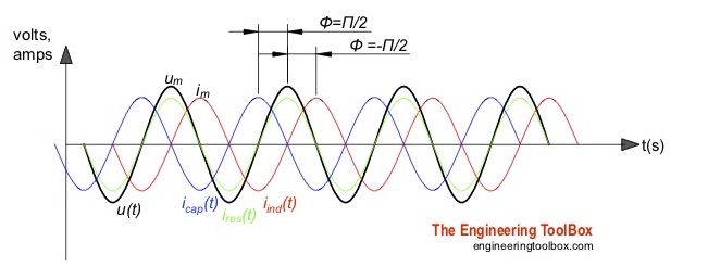

Voltage
AC current - voltage and current resistive, capacitive and inductive load
Currents in circuits with pure resistive , capacitive or inductive loads.

Currents in circuits with pure resistive, capacitive or inductive loads are indicated in the figure above. The current in a "real" circuit with resistive, inductive and capacitive loads are indicated in the figure below.

Resistive Load
The voltage over a resistive load in an AC system can be expressed as
U = R I                  (4)
R = resistance (ohm)
For a resistance load in an AC circuit the voltage is in phase with the current.
Inductive Load
The voltage over an inductive load in an AC system can be expressed as
U = j ω L I                (5)
L = inductance (henry)
For an inductive load the current in an AC circuit is π/2 (90o) phase after the voltage (or voltage before the current).
Capacitive Load
U = 1 / (j ω C) I                   (6)
C = capacitance (farad)
For a capacitive load the current in an AC circuit leads the voltage by π/2 (90o) phase .

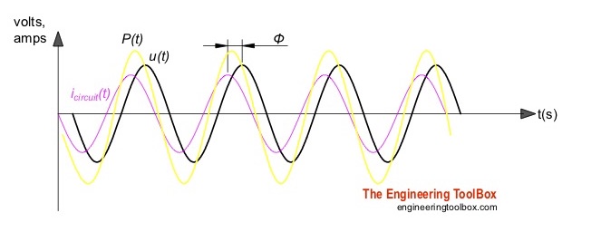

In a real electrical circuit there is a mix of resistive, capacitive and inductive loads with a voltage/current phase shift in the range - π/2 <= φ <= π/2 as illustrated in the figure below.
AC current in circuits wit resistive, capacitive and inductive loads
The current in a "real" circuit with a mix of resistive, inductive and capacitive loads. φ is the phase angle between the current and the voltage.

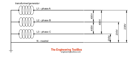

AC Three Phase Voltage - Line to Line and Line to Neutral
AC three phase supply system

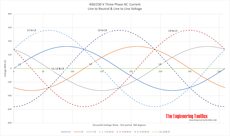

In an AC three phase system the voltage can be delivered between the lines and the neutral (phase potential), or between the lines (line potential). The resulting voltages for two common systems - the European 400/230V and the North American 208/120V system are indicated for one period in the figures below.
400V/230V AC
230V/400V AC Line to Line and Line to Neutral Voltage
print 400/230V Three Phase Diagram
  • L1, L2 and L3 are the three phases line to to neutral potentials - phase potentials
  • L1 to L2, L1 to L3 and L2 to L3 are the three phases line to line potentials - line potentials
  • L2, L2 and L3 is the resulting potential of the tree phases in a balanced circuit - resulting potential = 0
The magnitude of the line potentials is equal to 3 1/2 (1.73) the magnitude of the phase potential.
U rms, line = 1.73 U rms, phase                     (11)

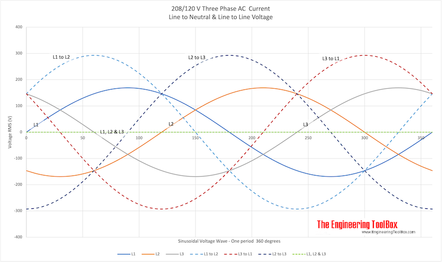

208V/120V AC
208V/120V AC Line to Line and Line to Neutral Voltage
print 208/120V Three Phase Diagram
