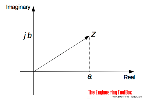

Complex numbers on the Cartesian form
A complex number consists of a real part and an imaginary part and can be expressed on the Cartesian form as
Z = a + j b                         (1)
Z = complex number
a = real part
j b = imaginary part (it is common to use i instead of j)
A complex number can be represented in a Cartesian axis diagram with an real and an imaginary axis - also called the Argand diagram:
Complex numbers - cartesian argand form example

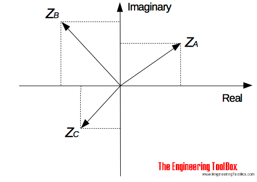

Example - Complex numbers on the Cartesian form
The complex numbers
ZA = 3 + j 2                              (2a)
ZB = -3 + j 3                             (2b)
ZC = -2 - j 2                             (2c)
can be represented in the Argand diagram:

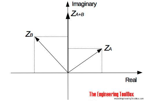

Addition and Subtraction of Complex numbers
Complex numbers are added/subtracted by adding/subtracting the separately the real parts and the imaginary parts of the number.
Example - Adding two Complex numbers
ZA = 3 + j 2
ZB = -3 + j 3
Z(A+B) = (3 + (-3)) + (j 2 + j 3)
         = j 5
complex number cartesian agrand form adding

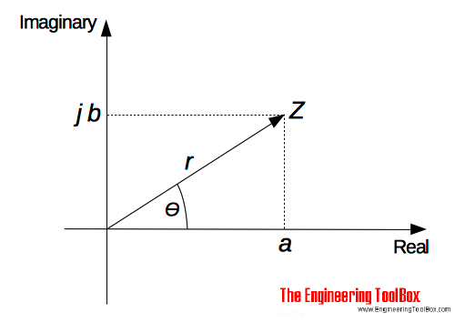

Complex numbers on the Polar form
A complex number on the polar form can be expressed as
Z = r (cosθ + j sinθ)                   (3)
r = modulus (or magnitude) of Z - and is written as "mod Z" or |Z|
θ = argument (or amplitude) of Z - and is written as "arg Z"
Complex numbers - polar form
r can be determined using Pythagoras' theorem
r = (a2 + b2)1/2                          (4)
θ can be determined by trigonometry
θ = tan-1(b / a)                          (5)
(3) can also be expressed as
Z = r ej θ                    (6)
As we can se from (1), (3) and (6) - a complex number can be written in three different ways.
