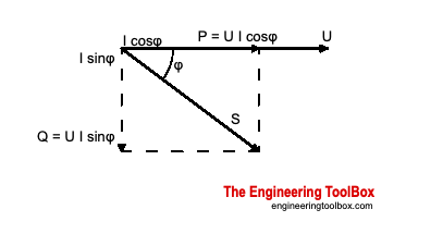

The power factor of an AC electric power system is defined as the ratio active (true or real) power to apparent power , where
  • Active (Real or True) Power is measured in watts ( W ) and is the power drawn by the electrical resistance of a system doing useful work
  • Apparent Power is measured in volt-amperes (VA) and is the voltage on an AC system multiplied by all the current that flows in it. It is the vector sum of the active and the reactive power
  • Reactive Power is measured in volt-amperes reactive ( VAR ). Reactive Power is power stored in and discharged by inductive motors, transformers and solenoids
Reactive power is required for the magnetization of an electric motor but does not perform any work. Reactive power required by inductive loads increases the amounts of apparent power -  and the required supply to the grid from the power supplier to the distribution system.
Increased reactive and apparent power will decrease the power factor - PF .
Power Factor
It is common to define the Power Factor - PF - as the cosine of the phase angle between voltage and current - or the " cosφ ":
PF = cos φ
PF = power factor
φ = phase angle between voltage and current

The power factor defined by IEEE and IEC is the ratio between the applied active (true) power - and the apparent power , and can in general be expressed as:
PF = P / S (1)
PF = power factor
P = active (true or real) power (Watts)
S = apparent power (VA, volts amps)

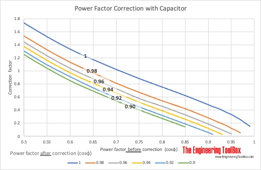

Power Factor Correction with Capacitor
Electrical Motors - Power Factor Correction with Capacitor
Power factor before improvement (cosΦ)
Capacitor correction factor
Power factor after improvement (cosΦ)
1.00.990.980.970.960.950.940.930.920.910.90
0.50 1.73 1.59 1.53 1.48 1.44 1.40 1.37 1.34 1.30 1.28 1.25
0.55 1.52 1.38 1.32 1.28 1.23 1.19 1.16 1.12 1.09 1.06 1.04
0.60 1.33 1.19 1.13 1.08 1.04 1.01 0.97 0.94 0.91 0.88 0.85
0.65 1.17 1.03 0.97 0.92 0.88 0.84 0.81 0.77 0.74 0.71 0.69
0.70 1.02 0.88 0.81 0.77 0.73 0.69 0.66 0.62 0.59 0.56 0.54
0.75 0.88 0.74 0.67 0.63 0.58 0.55 0.52 0.49 0.45 0.43 0.40
0.80 0.75 0.61 0.54 0.50 0.46 0.42 0.39 0.35 0.32 0.29 0.27
0.85 0.62 0.48 0.42 0.37 0.33 0.29 0.26 0.22 0.19 0.16 0.14
0.90 0.48 0.34 0.28 0.23 0.19 0.16 0.12 0.09 0.06 0.02
0.91 0.45 0.31 0.25 0.21 0.16 0.13 0.09 0.06 0.02
0.92 0.43 0.28 0.22 0.18 0.13 0.10 0.06 0.03
0.93 0.40 0.25 0.19 0.15 0.10 0.07 0.03
0.94 0.36 0.22 0.16 0.11 0.07 0.04
0.95 0.33 0.18 0.12 0.08 0.04
0.96 0.29 0.15 0.09 0.04
0.97 0.25 0.11 0.05
0.98 0.20 0.06
0.99 0.14
Power factor correction with capacitors
Example - Improving power factor with capacitor
An electrical motor with power 150 kW has power factor before improvement cosΦ = 0.75 .
For a required power factor after improvement cosΦ = 0.96 - the capacitor correction factor is 0.58 .
The required KVAR capacity can be calculated as
C = (150 kW) 0.58
= 87 KVAR
