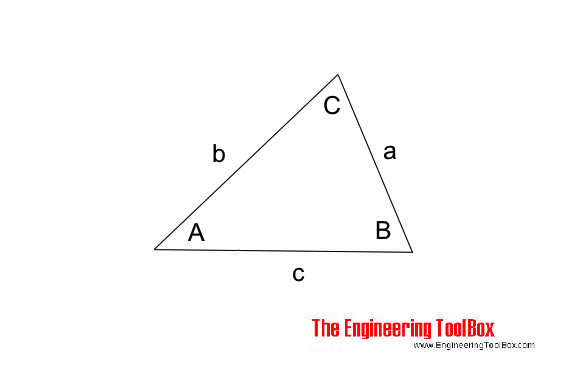

The "Law of Cosines" can be used to calculate one side of a triangle when the angle opposite and the other two sides are known.
Law of cosines
The "Law of Cosines" can be expressed as
$$ c^2 = a^2 + b^2 - 2 a  b cos C            \tag{1} $$
a, b and c = length of triangle sides (m, ft ..)
C = angle opposite side c (degrees)
Example - Calculate Side in Triangle
If side a = 1 m, side b = 1.3 m and angle C = 60 degrees - the side c can be calculated by modifying eq. 1 to
$$ c = \sqrt{ (1 m)^2 + (1.3 m)^2 - 2 (1 m) (1.3 m) cos (60 degrees) }  = \underline{1.18} m         $$

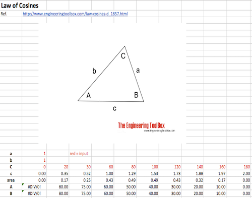

Law of Cosines - Excel Template
Law of cosines - excel template
