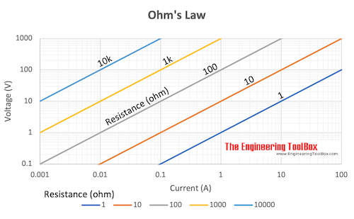

Electrical Potential - Ohm's Law
Ohm's law can be expressed as:
U = R I                        (1a)
U = P / I                      (1b)
U = (P R)1/2                (1c)
Ohm's Law - Voltage vs. current and resistanceDownload and print Ohm's Law

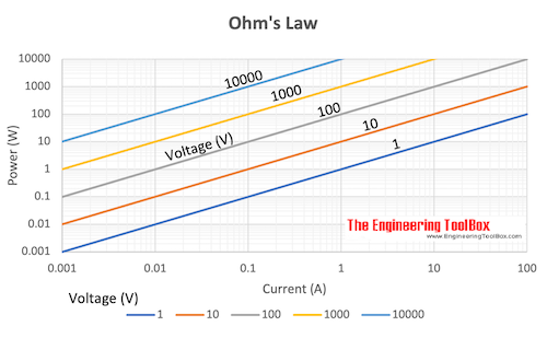

Electric Power
P = U I                      (4a)
P = R I2                    (4b)
P = U2/ R                  (4c)
P = power (watts, W, J/s)
U = voltage (volts, V)
I = current (amperes, A)
R = resistance (ohms, Ω)
Ohm's Law - Power vs. current and resistanceDownload and print Ohm's Law
Ohm's Law - Power vs. current and voltage
