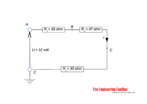

If voltage at point A is quoted with reference to the earth point - the absolute potential - then the voltage is written UA.
Relative Voltage
If voltage at point A is quoted with reference to point B - then the voltage is written UAB.
Example - Relative and Absolute Voltage
The total resistance in the series circuit above can be calculated
R = (33 ohm) + (47 ohm) + (33 ohm)
   = 113 ohm
The current in the circuit can be calculated
I = (12 volts) / (113 ohm)
  = 0.11 ampere
The relative voltage between point A and BVAB - can be calculated
UAB = (33 ohm) (0.11 ampere)
      = 3.6 volts
The absolute voltage in point A relative to earth is
UA = 12 V
The absolute voltage in point B relative to earth is
UB = UA - UAB
    = (12 volt) - (3.6 volt)
    = 8.4 volt
