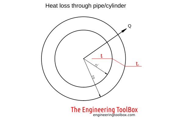

Conductive heat loss through the wall of a cylinder or pipe can be expressed as
Q = 2 π L (ti - to) / [ln(r/ ri) / k]                              (1)
Q = heat transfer from cylinder or pipe (W, Btu/hr)
k = thermal conductivity of piping material (W/mK or W/m oC, Btu/(hr oF ft2/ft))
L = length of cylinder or pipe (m, ft)
π = pi = 3.14...
to = temperature outside pipe or cylinder (K or oC, oF)
ti = temperature inside pipe or cylinder (K or oC, oF)
ln = the natural logarithm
ro = cylinder or pipe outside radius (m, ft)
ri = cylinder or pipe inside radius (m, ft)
