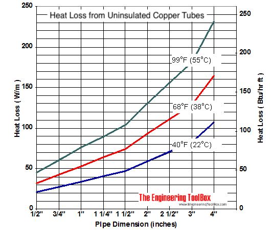

Heat loss at various temperature differences between pipe and ambient air for 1/2" to 4" copper tubes - or pipes - are indicated below:
Uninsulated copper tube - heat loss diagram
Note that it is temperature difference that is used - and that 1 oC of temperature difference equals to 1.8 oF temperature difference.

Example - Heat Loss from a 2" Pipe
A 2" pipe with temperature 75 oC (167 oF) is located in a room with temperature 20 oC (68 oF). The temperature difference between the pipe and the ambient room is 55 oC (99 oF).
The heat loss from the pipe to the room can be estimated from the table (or chart) above to 131 W/m.
