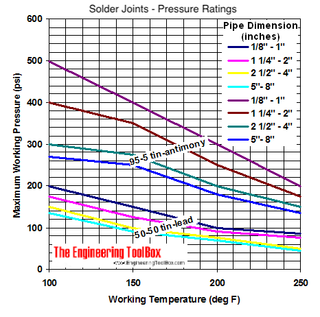

Solder joints and their pressure ratings according ASME B16.18.
Pressure ratings of solder joints according ASME B.16.18:
Solder joints  - pressure ratings diagram
50-50 Tin-Lead
Pressure rating 50-50 tin-lead are indicated in the table below:
Solder Joints - Pressure Ratings vs. Temperature - 50-50 Tin-Lead
TemperaturePipe Dimension (inches)
1/8" - 1"1 1/4" - 2"2 1/2" - 4"5" - 8"
(oF)(oC)Maximum pressure
(psi)(bar)(psi)(bar)(psi)(bar)(psi)(bar)
100 38 200 14 175 12 150 10 135 9
150 66 150 10 125 9 100 7 90 6
200 93 100 7 90 6 75 5 70 5
250 121 85 6 75 5 50 3 45 3
95-5 Tin-Antimony
Pressure rating 95-5 tin-antimony are indicated in the table below:
Solder Joints - Pressure Ratings vs. Temperature - 95-5 Tin-Antimony
100 38 500 35 400 28 300 21 270 19
150 66 400 28 350 24 275 19 250 17
200 93 300 21 250 17 200 14 180 12
250 121 200 14 175 12 150 10 135 9
