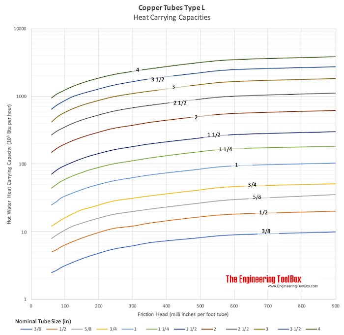

Hot water heat carrying capacities in copper tubes type L.
Copper tubes are often used in hot water heating systems, especially to connect heating elements like radiators, fan units and similar to the main pipe lines.
Copper Tube - Heat Carrying Capacity
Download and print Copper Tubes - Heat Carrying Capacities diagram
The table below can be used to estimate hot water heat carrying capacity in copper tubes type L:
Hot Water Heat Carrying Capacity in Type L Copper Tube

1) The table is designed for temperature drop 20 oF (11 oC) in radiators and heating elements. For other temperature drops the values must be changed accordingly. With temperature drop 10 oF (5.5 oC) - multiply the capacities with 0.5.
