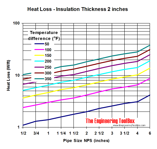

Heat loss (W/ft) diagrams for 1/2 to 6 inches insulated pipes - ranging insulation thickness 0.5 to 4 inches and temperature differences 50 to 350 degF.
The heat loss diagrams below is based on metal pipes with fiber glass insulation, thermal conductivity 0.25 Btu/h oF ft2/in and outdoor condition with moderate wind 20 mph. A safety factor of 10% is included.
  • indoor location - reduce values with 10%
  • mineral wool insulation - increase values with 6%
  • rigid cellular polyurethane - reduce values by 30%
  • Heat loss diagram (W/ft)

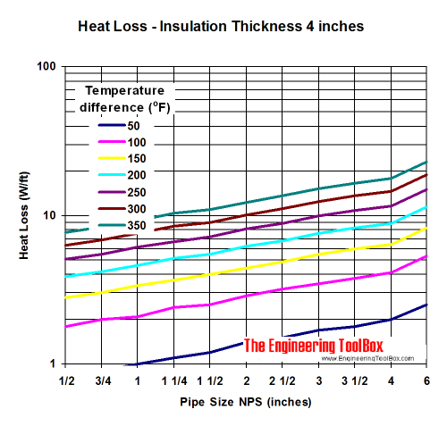

Pipe Heat Loss - Insulation thickness 4 inches
Pipe heat loss diagram - insulation thickness 4 inches
  • 1 W/ft = 3.41 Btu/h ft = 3.28 W/m
  • 1 oF = 0.555 oC

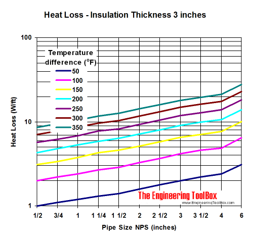

Pipe Heat Loss - Insulation thickness 3 inches
Pipe heat loss diagram - insulation thickness 3 inches

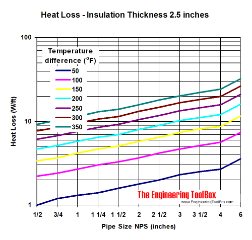

Pipe Heat Loss - Insulation thickness 2.5 inches
Pipe heat loss diagram - insulation thickness 2.5 inches
Pipe Heat Loss - Insulation thickness 2 inches
Pipe heat loss diagram - insulation thickness 2 inches

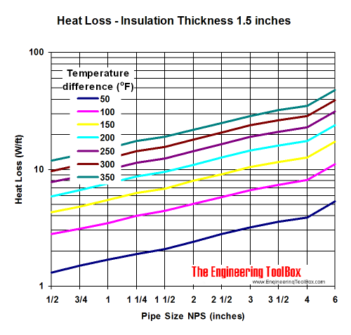

Pipe Heat Loss - Insulation thickness 1.5 inches
Pipe heat loss diagram - insulation thickness 1.5 inches

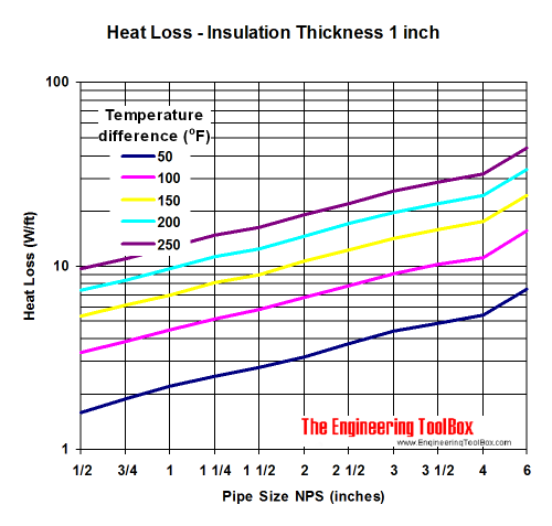

Pipe Heat Loss - Insulation thickness 1 inch
Pipe heat loss diagram - insulation thickness 1 inch

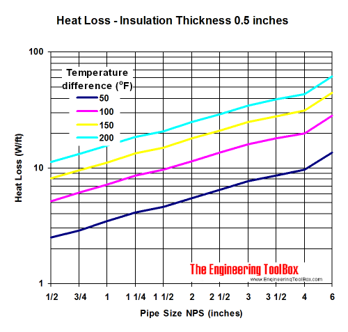

Pipe Heat Loss - Insulation thickness 0.5 inches
Pipe heat loss diagram - insulation thickness 0.5 inches
