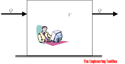

Fresh air supply - make up air - to a room based on the table above can be calculated as
q = n V                                        (1)
q = fresh air supply (ft3/h, m3/h)
n = air change rate (h-1)
V = volume of room (ft3, m3)
Example - Fresh Air Supply to a Public Library
The fresh air supply to a public library with volume 1000 m3 can be calculated as
Q = (4 h-1) (1000 m3)
    = 4000 m3/h
