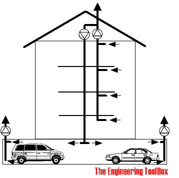

Alternative Systems
A typical ventilation system for a smaller garage
ventilation of garage
The fresh air is supplied through openings in the outside wall. Polluted air is evacuated through openings close to the floor and the roof.
For larger buildings and garages it is common to use outlet air from the ventilation systems in the surrounding buildings as fresh make-up air to the garages.
ventialtion garage from larger house
Air with room temperature (or temperature after the heat recovery unit) is supplied to the garage. Polluted air is evacuated through openings close to the floor and the roof.
