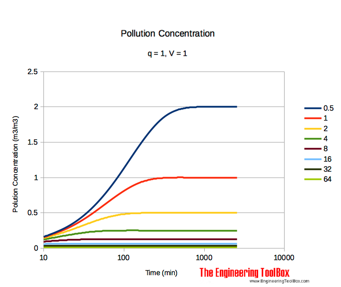

If the start concentration (t = 0) of the space and the concentration in the supply fluid is zero, equation (1) can be reduced to
c = q / n V (1 - e-nt)                                   (2)
Note! After some time the concentration in the room will stabilize. The table below shows the value of c when the amount of pollution q = 1, and the volume of the space V = 1.

1020408016032064012802560
0.5 0.1599 0.3070 0.5669 0.9732 1.4728 1.8610 1.9903 2.0000 2.0000
1 0.1535 0.2835 0.4866 0.7364 0.9305 0.9952 1.0000 1.0000 1.0000
2 0.1417 0.2433 0.3682 0.4653 0.4976 0.5000 0.5000 0.5000 0.5000
4 0.1216 0.1841 0.2326 0.2488 0.2500 0.2500 0.2500 0.2500 0.2500
8 0.0921 0.1163 0.1244 0.1250 0.1250 0.1250 0.1250 0.1250 0.1250
16 0.0582 0.0622 0.0625 0.0625 0.0625 0.0625 0.0625 0.0625 0.0625
32 0.0311 0.0312 0.0312 0.0313 0.0313 0.0313 0.0313 0.0313 0.0313
64 0.0156 0.0156 0.0156 0.0156 0.0156 0.0156 0.0156 0.0156 0.0156
