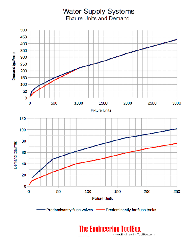

Building Water Supply Diagram in gal/min
Fixtures - WFSU - and building water demand supply diagram - gallons per minute

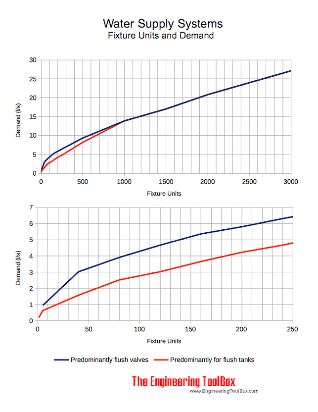

Building Water Supply Diagram in l/s
Fixtures - WFSU - and building water demand supply diagram - litre per second
