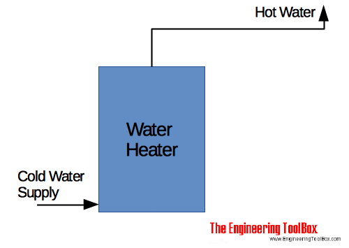

Water Heater - Single Temperature
The water is heated and stored in the same storage tank at the same temperature as supplied to the consumers.
Water heater - single temperature

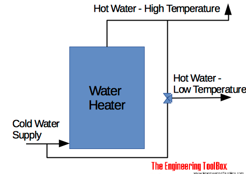

Water Heater - Two Temperature with Mixing Valve
The water is heated and stored in the same storage tank at higher temperature than supplied to most of the consumers. The hot water is mixed down to consumer temperature with cold water before supplied to the fittings.
Hot water supply - heater with two temperature mixing valve

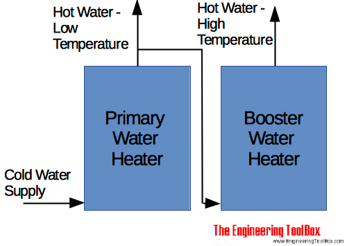

Water Heater - Two Temperature with Boosting Tank
The water is heated and stored at consumer temperature before distributed to normal consumers. Water from this store is supplied to an other heater and storage tank where the water is heated to higher temperatures before distribution.
Hot water supply - two temperature boosting tank

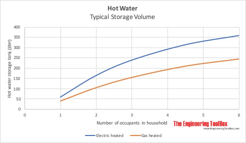

Typical Hot Water Storage Volume
Typical hot water storage volume for electric or gas heated systems vs. number of occupants in household:
Hot water storage for electric or gas heated systems vs. number of occupants in household

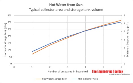

Hot Water from Sun
The diagram below indicates typical minimum collector area and storage volume vs. occupants in a household for solar hot water production.
Hot water from sun - minimum collector area and storage volume vs. occupants in household
