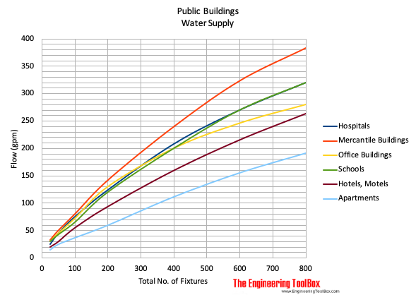

Required water supply to public buildings.
Typical required water supply to public buildings:
Public buildings - required water supply diagram
  • 1 gpm =6.30888x10-5 m3/s = 0.227 m3/h
