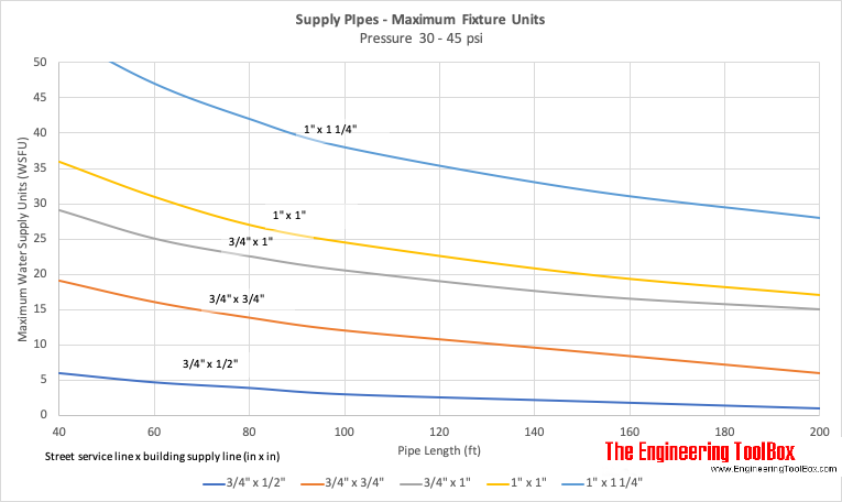

Due to intermittent use of the fixtures in a water supply system it can be difficult to predict and size the supply and service lines. The fixtures total theoretical demand should always be compensated with a statistic more expected demand.
With the Water Supply Fixture Units (WSFU) system defined by the Uniform Plumbing Code (UPC) there are tables available where the total demand calculated by adding each units "Water Supply Fixture Units" (WFSU) are compensated to an expected demand.
The tables below can be used to size building supply and branch lines and meter and service lines.
Supply pressure 30 - 45 psi
Water Supply Lines - Sizing - Supply pressure 30 - 45 psi
Meter and street service lines

Maximum Water Supply Fixture Units (WSFU)
Length of pipe (feet)
406080100150200
3/4 1/2 6 5 4 3 2 1
3/4 19 16 14 12 9 6
1 29 25 23 21 17 15
1 1 36 31 27 25 20 17
1 1/4 54 47 42 38 32 28
