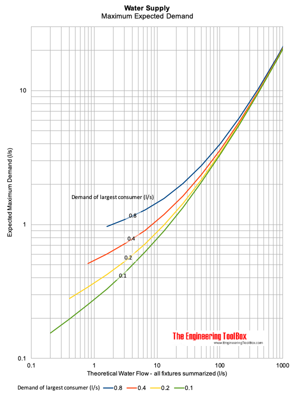

Adding up the numbers to cover all fixtures in a system would give the total demand if all fixtures were used at the same time. This is  almost never realistic for a supply system. Reasonable estimates must be made based on simultaneously demand from the fixtures.
Water supply - expected demand vs. no. fixtures
Example - Required Water Supply
For a water supply system the summarized theoretical water flow for all fixtures is 10 l/s. The largest fixture in the system requires 0.4 l/s.
Based on the diagram above the expected total water flow in the system will be aprox. 1.1 l/s.
