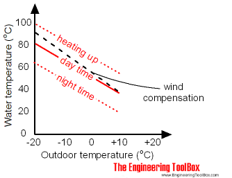

Keeping the hot water design temperature constant through the heating season makes the modulating control valves on the heating elements to perform mostly outside their design range. Modulating valves do not perform very well with a reduced flow at nearly closed positions.
Hot water heating system - outdoor temperature compensation
By reducing the water temperature at higher outdoor temperatures as shown in the diagram above the modulating valves will operate in their design range with much better performance.
