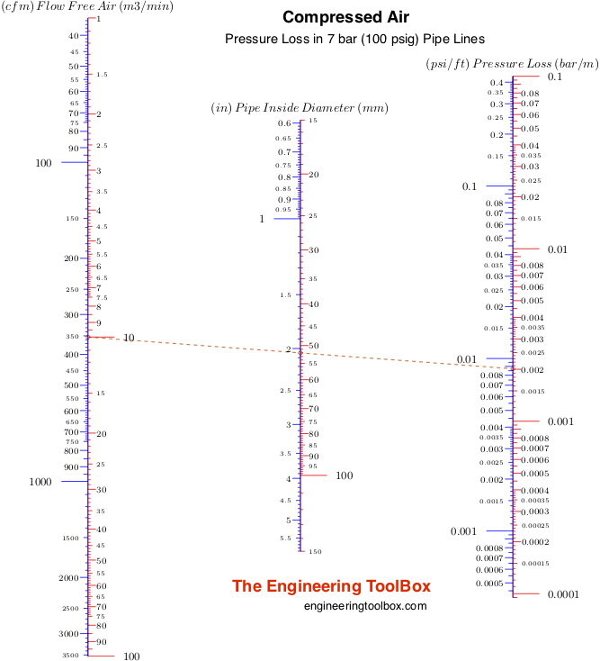

Compressed Air - Pressure Drop Nomogram
The nomogram below can be used to estimate pressure drops in compressed air pipe lines with pressure 7 bar (100 psig).

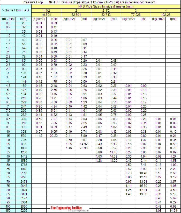

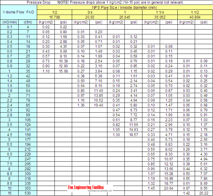

Compressed Air Pipeline Pressure Drop Table - Initial gauge Pressure 7 kg/cm2 (100 psig)
Pressure drops in 100 m (330 ft) compressed air schedule 40 steel pipe lines are indicated in the tables below:
