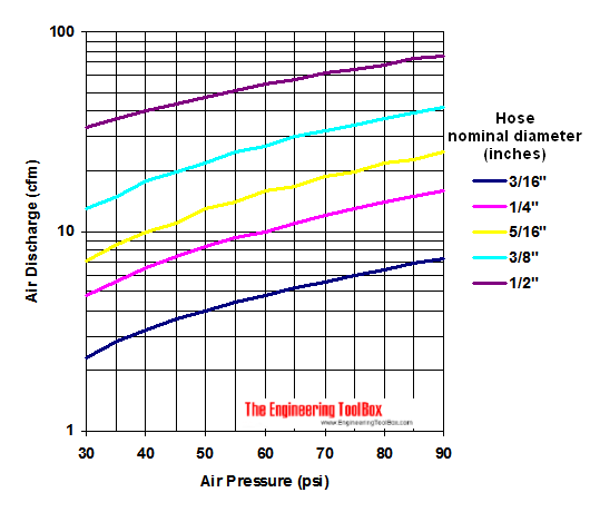

Compressed Air - Air Flow Discharge through Hoses
Discharged air flow volume through hoses with pressure ranging 30 - 90 psi.
Air volume discharged through a 100 feet hose - pressure ranging 30 - 90 psi:
air volume discharge through hose
  • 1 psig = 6.9 kPa = 0.069 bar
  • 1 ft (foot) = 0.3048 m
  • 1 scfm = 0.472 nl/s
