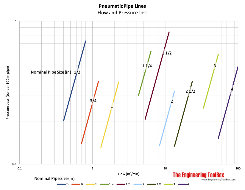

Pressure loss in pneumatic tubes - sizes ranging 5 - 36 mm.
Pressure loss in pneumatic pipe lines are indicated below. The diagram is calculated for
Pneumatic pipes and tubes - pressure loss chart in bar
