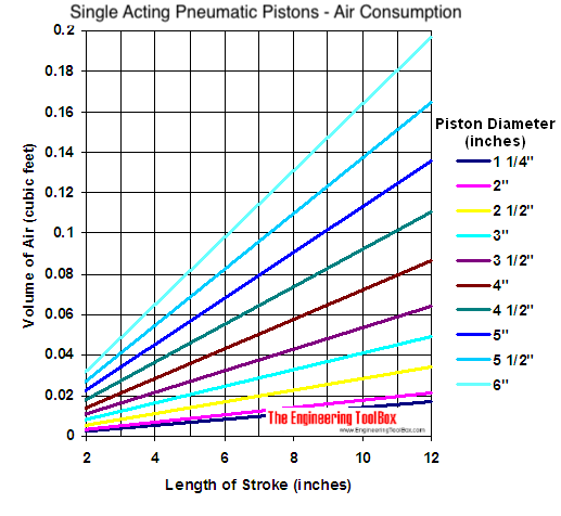

Calculate air volume used by a single-acting piston.
The diagram below indicates air volume used by single-acting pistons:
Pneumatic single acting piston - air volume diagram
