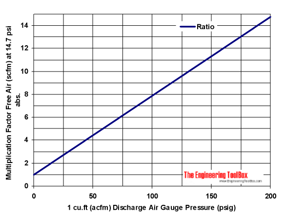

The compression ratio of free air - to compressed air, is indicated in the diagram below.
Compression Ratio - Pressure (psi)
Compression ratio - pressure of compressed air to pressure of free suction air diagram - psi
  • 1 psi = 6.9 kPa = 0.069 bar
  • 1 ncfm = 0.5 nl/s
Converting Compressed Air Volume Flow to Free Air Volume Flow
A compressed air volume flow can be converted to a free air volume flow by using the equation
qF = CR qC                            (2)
qF = free air flow (m3/s, cfm)
qC = compressed air flow (m3/s, cfm)
Example - Converting Compressed Air Volume Flow to Free Air Volume Flow
A compressed air volume flow of 10 acfm (actual cfm) at 100 psig must be multiplied with Compression Ratio approximately 8 to estimate the volume of free air at atmospheric pressure.
qF = 8 (10 acfm)
    = 80 scfm  (standard cfm)

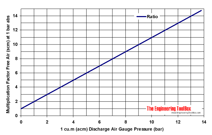

Compression Ratio - Pressure (bar)
Compression ratio - pressure of compressed air to pressure of free suction air diagram - bar
Example - Converting Free Air Volume Flow to Compressed Air Volume Flow
A free air volume flow of 1 m3/s is compressed to 10 bar (gauge) and must be divided with Compression Ratio approximately 11 to estimate the volume of compressed air.
qC = (1 m3/s) / 11
             = 0.091 m3/s
