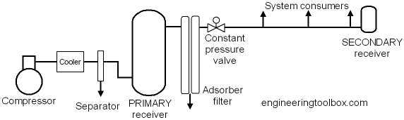

An air receiver is essential to every compressed air system to act as a buffer and a storage medium between the compressor and the consumption system. There are in principal two different air receivers in a compressed air system:
  • PRIMARY receiver - located near the compressor, after the after-cooler but before filtration and drying equipment
  • SECONDARY receivers - located close to points of larger intermittent air consumption
air compressor assembly

Air receivers in compressed air systems serves the important purposes of
  • equalizing the pressure variation from the start/stop and modulating sequence of the compressor
  • storage of air volume equalizing the variation in consumption and demand from the system
In addition the receiver serve the purpose of
  • collecting condensate and water in the air after the compressor

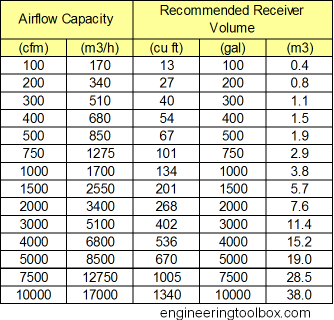

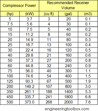

It is also common to size receivers

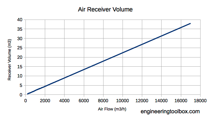

  • to 1 gallon for each ACFM (Actual Cubic Feet per Minute), or
  • 4 gallons per compressor hp (horse power)
compressed air volume flow and recommended air receiver volume
compressed air power and recommended air receiver volume
