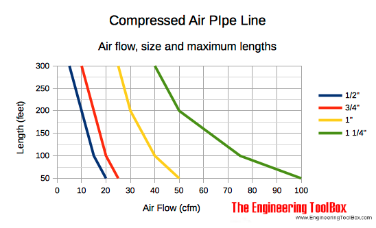

Recommended sizes for compressed air pipe lines:
air pipe line - recommended sizes
Based on line presssure 90 psig (620 kPa, 6.2 bar).
  • 1 psig = 6.9 kPa = 0.069 bar
  • 1 inch = 25.4 mm
  • 1 ft (foot) = 0.3048 m
  • 1 scfm = 0.472 nl/s

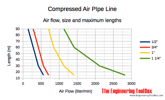

air pipe line - recommended sizes - metric units
