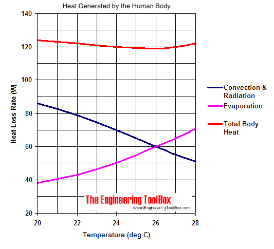

Heat Generated from Human Body
The diagram below is for moderate activity- seated, very light work - computer working person.
Human body heat - metabolism
  • sensible heat = convection and radiation
  • latent heat = evaporation
