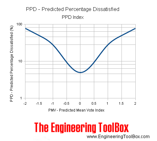

PPD - Predicted Percentage Dissatisfied Index
Predicted Percentage Dissatisfied - PPD - index is a quantitative measure of the thermal comfort of a group of people at a particular thermal environment.
Note! - at least aprox. 5% of people in a group will be dissatisfied with the thermal climate - even with PMV = 0.
