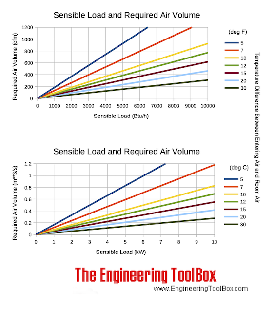

Sensible Heat Load and Required Air Volume Chart
Sensible heat load - heating or cooling - and required air volume to keep temperature constant at various temperature differences between entering air and room air are indicated in the chart below:
Sensible heat and required air volume

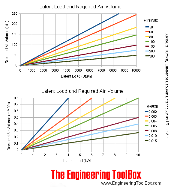

Factors that influence to the latent cooling load
Moisture is introduced into a structure through:
  • People
  • Equipment and appliances
  • Air infiltration through cracks in the building, doors, and windows
Other latent heat gain is taken care of by the HVAC equipment before the air reaches the rooms (system gain).
Latent Heat Load and Required Air Volume Chart
Latent heat load - humidifying and dehumidifying - and required air volume to keep temperature constant at various temperature differences between entering air and room air are indicated in the chart below:
Latent heat and required air volume
