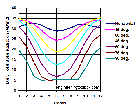

Solar energy accumulated on south faced horizontal to vertical tilted surfaces on the northern hemisphere latitude 0oN, 30oN and 60oN - are indicated in the diagrams below:
Solar Radiation - Latitude 0oN
solar radiation diagram - surfaces 0 deg North
  • 1 MJ = 0.278 kWh = 239 kcal = 948 Btu
  • 1 m2 = 1550 in2 = 10.764 ft2

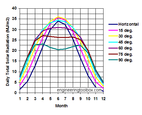

Solar Radiation - Latitude 30oN
solar radiation diagram - surfaces 30 deg North

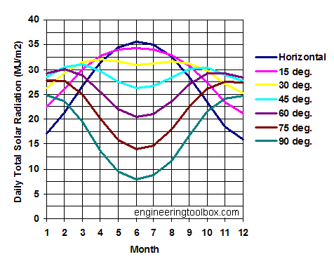

Solar Radiation - Latitude 60oN
solar radiation diagram - surfaces 60 deg North
At equator there may be enough radiation in winter time to consider year-round applications. In the northern hemisphere we have to look for applications that requires energy mainly in summer time.
