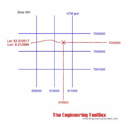

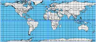

In the UTM coordinate system a grid is used to specify locations on the surface of the Earth. The UTM system is not a single map projection but instead series of sixty zones. Each zone is based on a specifically defined secant Transverse Mercator projection. The units for both east and north coordinates are meters.
UTM coordinates vs. latitude and longitude
The UTM north coordinate is the projected distance from equator for all zones. The east coordinate is the distance from the central meridian.

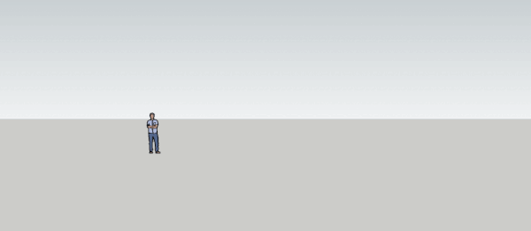

Insert UTM coordinated properties in Sketchup models with the Engineering ToolBox Sketchup extension.
UTM coordinated property insert in Sketchup
