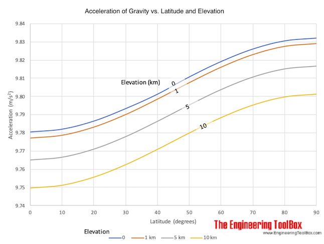

Acceleration of gravity at sea level and elevation related to north-south position on earth (degrees latitude):
Acceleration of Gravity vs. Latitude and Elevation (m/s2)
Latitude and acceleration of gravity - meter per second second

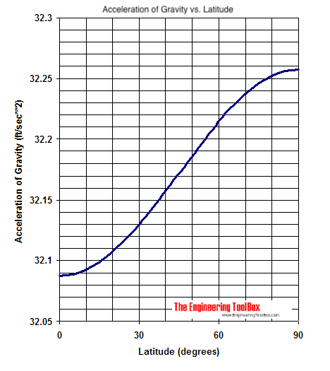

Acceleration of Gravity vs. Latitude (ft/s2)
Latitude - acceleration of gravity - feet per second second
