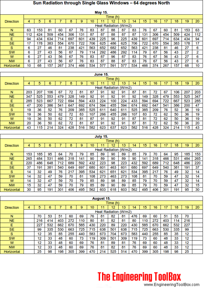

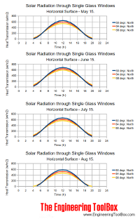

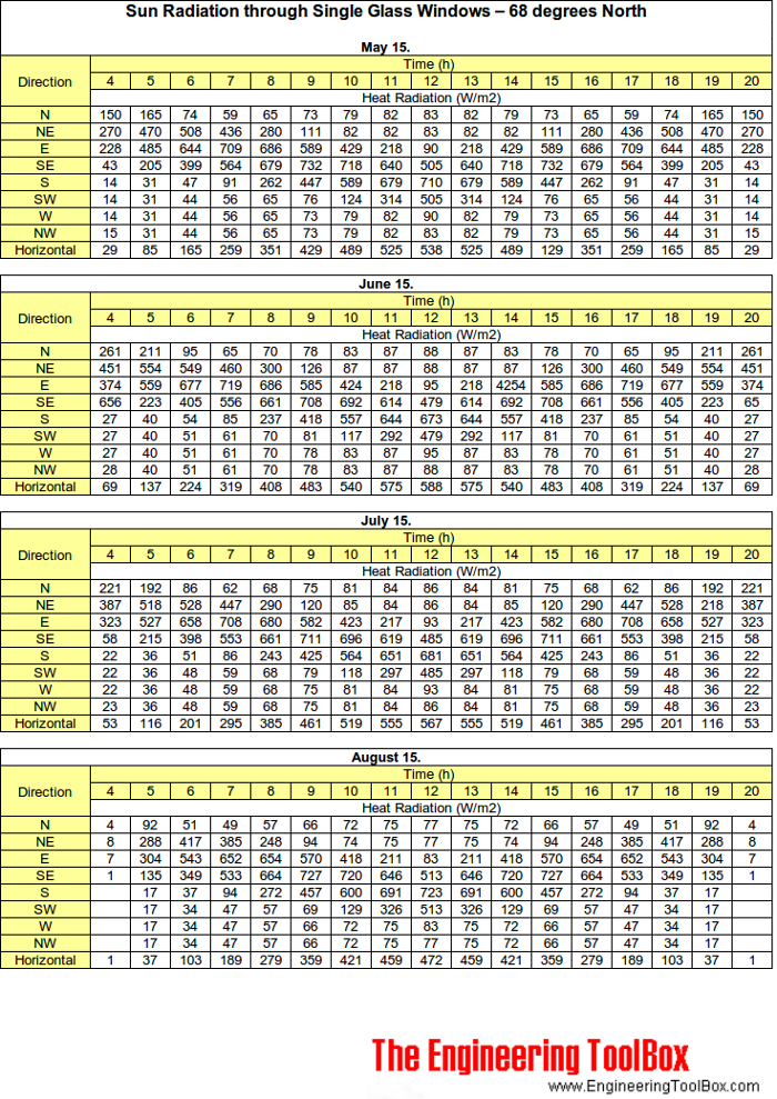

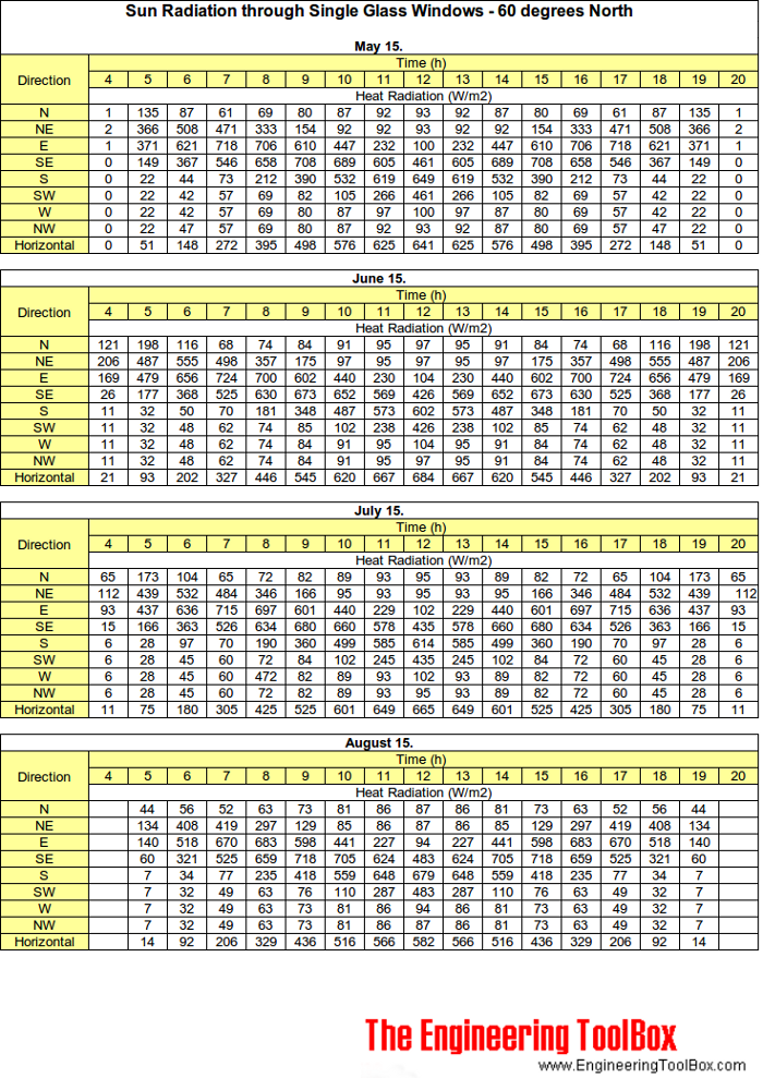

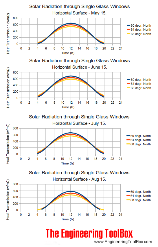

Solar heat transmitted through vertical and horizontal single glass windows at 60, 64 and 68 degrees north:
Solar radiation - heat transmission through glass windows
Solar Radiation through Single Glass Windows - 60o North
Solar radiation through windows

Solar Radiation through Single Glass Windows - 68o North
