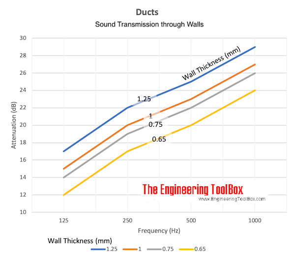

Typical sound transmission loss through duct walls are indicated in the table below:
Sound Transmission through Duct Walls - Attenuation - TL - (dB)
Duct sheet
thickness
(mm)
Frequency (Hz)
1252505001000
1.25 17 22 25 29
1.0 15 20 23 27
0.75 14 19 22 26
0.65 12 17 20 24
The acoustic performance of round and oval ducts is superior to rectangular ducts since their curved surfaces allow less breakout noise. Low-frequency sound is better contained in round ducts.
