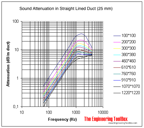

Noise attenuation in rectangular straight, lined, sheet metal ducts.
Attenuation in ducts with 25 mm lining are indicated below:
Sound Attenuation of Lined Sheet-Metal Ducts

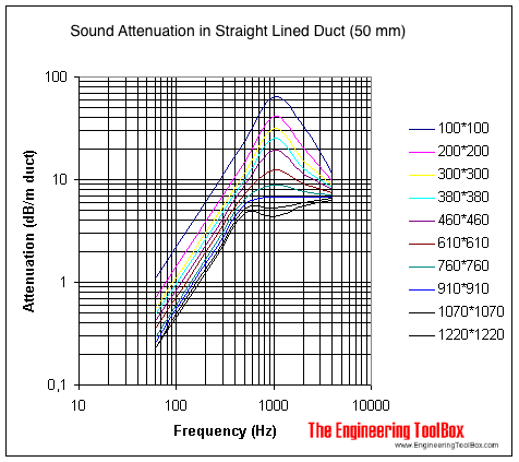

Attenuation in ducts with 50 mm lining are indicated below:
