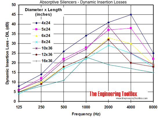

Typical DIL - Dynamic Insertion Losses (decibel) - with absorptive silencers are indicated in the table and diagram below

DIL - Dynamic Insertion Loss - (dB)
Diameter
(inches)
Length
(inches)
Frequency (Hz)
1252505001000200040008000
4 24 8 14 26 34 41 45 25
5 24 6 12 22 28 37 38 22
6 24 5 10 18 23 33 30 19
8 24 4 9 17 22 29 25 18
10 36 6 11 21 27 39 25 19
12 36 5 9 18 23 32 20 18
16 36 5 8 11 23 19 17 15
  • (1 in) = (25.4 mm)
