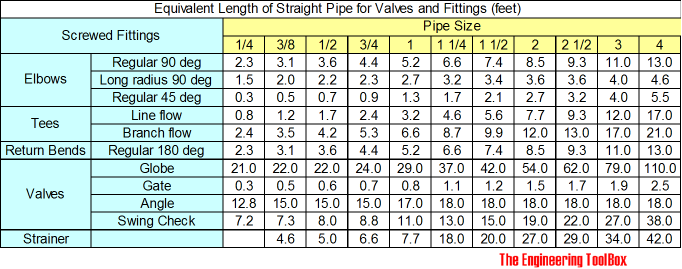

Screw Fittings - equivalent length in feet
Equivalent length (in feet) of straight pipe for fittings like bends, returns, tees and valves. (Pipe size in inches)
Piping - Equivalent length of screwed fittings - feet

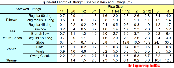

Screw Fittings - equivalent length in meter
Equivalent length (in meter) of straight pipe for fittings like bends, returns, tees and valves.
Piping - equivalent length of screwed fittings - meter

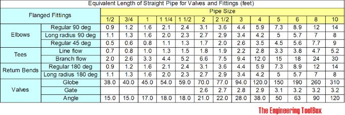

Flange Fittings - equivalent length in feet
Piping - equivalent length of flanged fittings - feet

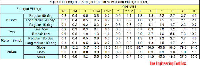

Flange Fittings - equivalent length in metre
Piping - equivalent length of flanged fittings - meter
