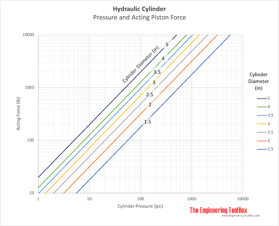

Imperial Units

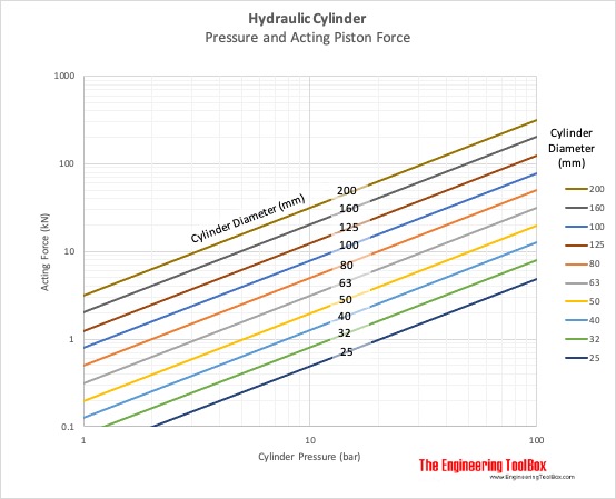

Hydraulic Cylinder - Cylinder Diameter, Pressure and Rod Force - Imperial Units psi
Metric Units
Hydraulic Cylinder - Cylinder Diameter, Pressure and Rod Force - Metric Units bar
