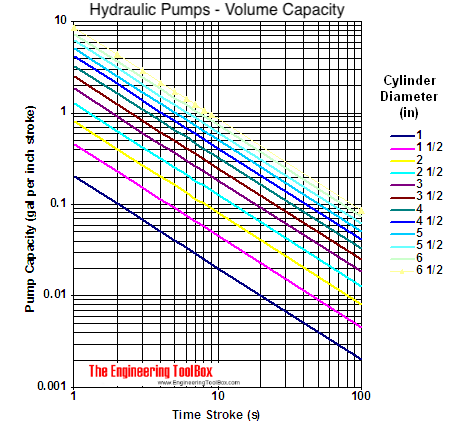

Required pump output for hydraulic cylinders ranging 1 - 6 1/2 inches are indicated below. Multiply pump capacity with stroke length (in).
Hydraulic pumps - output capacity vs. cylinder diameter graph
Example - Required Pump Capacity
A 3" hydraulic cylinder with cylinder area 7.065 in2 makes a 30 inches stroke in 3 seconds. The required pump capacity can be calculated
 q = 0.26 (7.065 in2) (30 in) / (3 s)
    = 18.4 gpm
